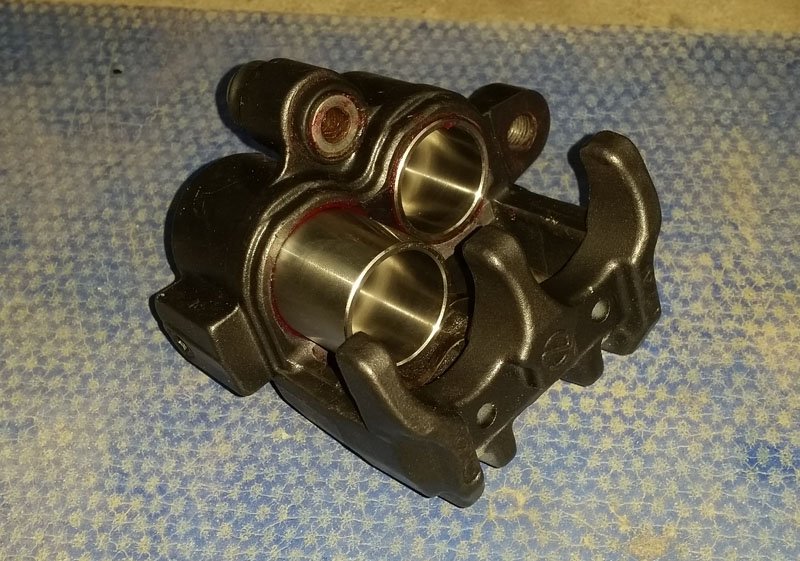

and theres so much of it on the bol, fitted new stainless steel pistons to all calipers yesterday,
Big thank you to bif for sorting the piston rings, caliper pistons, and a nudge in the right direction reguarding carb settings
nice new shiney stainless steel pistons
calipers

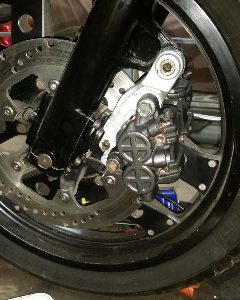

Those fork sliders and calipers look just like the ones on my VF500 bikes.
Never knew they were common (if they are).

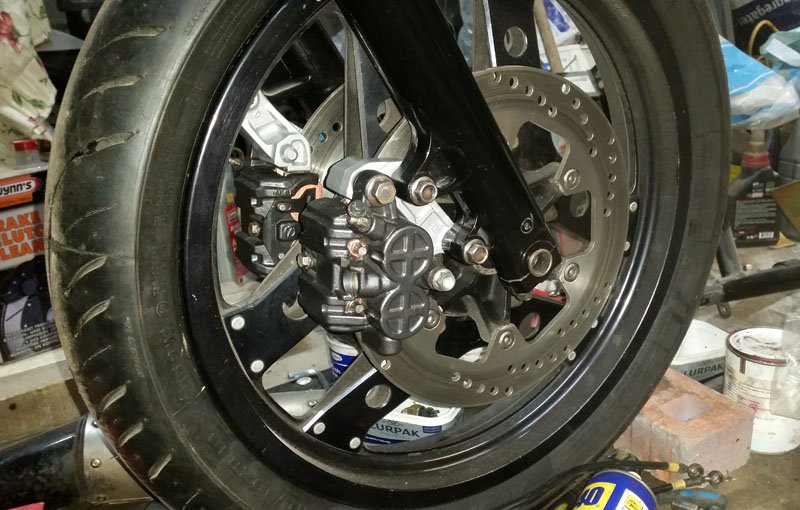

managed to get some spraying done over the last week or so,
